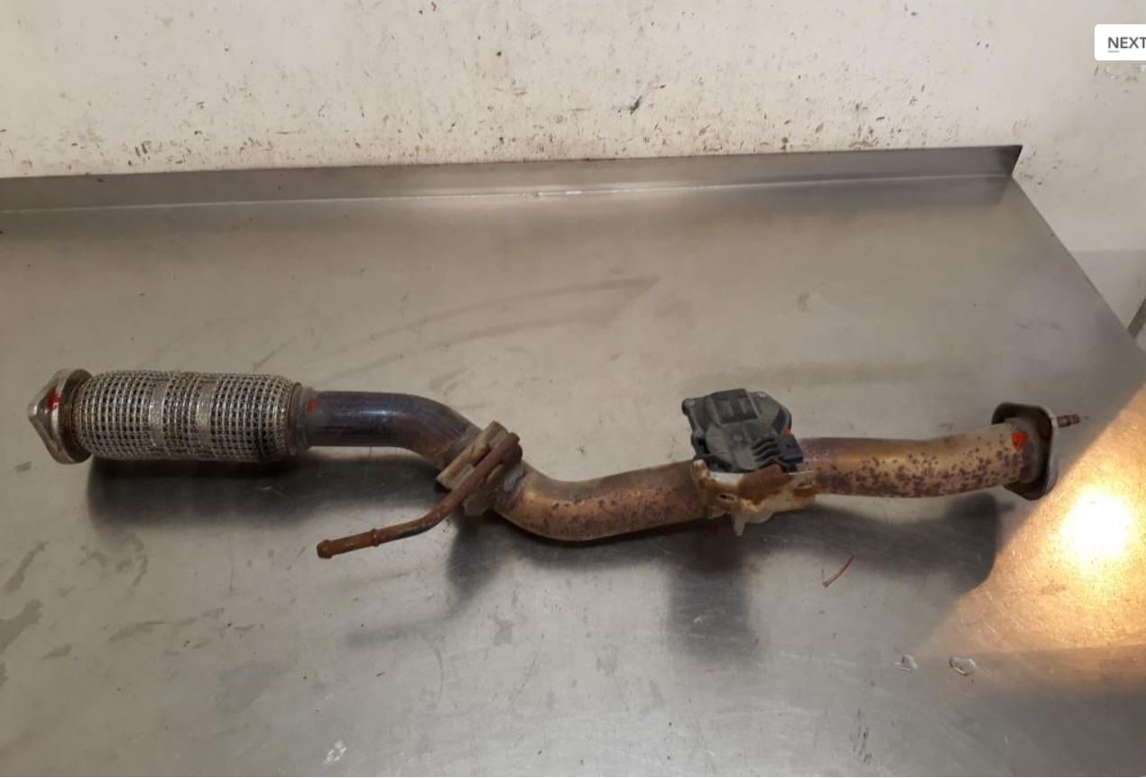

Re: Check Anti-Pollution System
I think mine costed more because they replaced this whole part, not only the valve. They said they need to replace the whole thing, thats how they dealt with this kind of problems. ( Pic taken from google )
